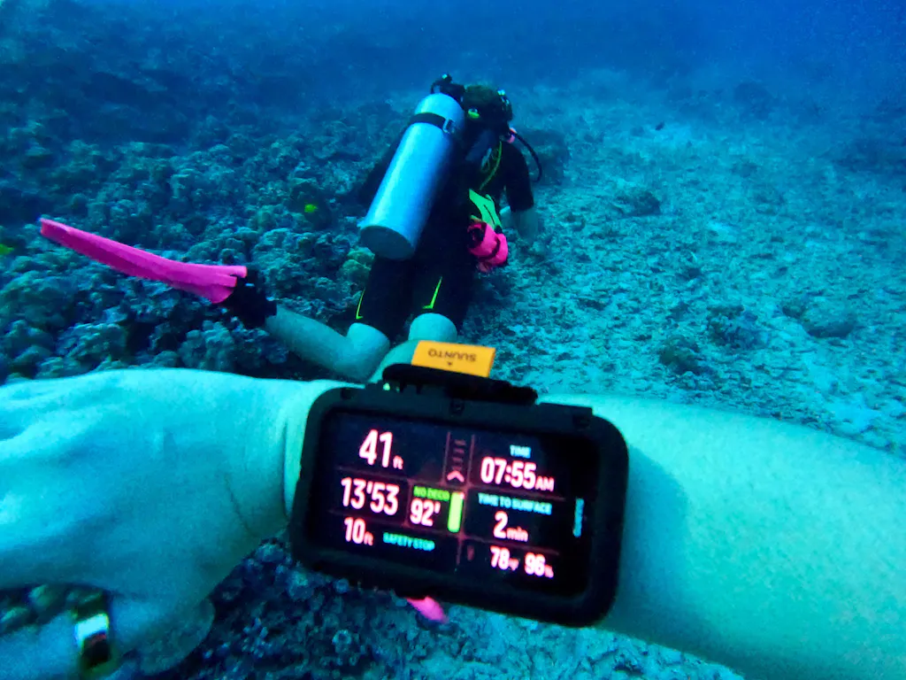

TOP TIER DIVE COMPUTER!!!
I am a beginner diver and price was not a deciding factor for me. I had an unlimited budget and seriously evaluated top tier dive computers from Garmin and Shearwater Research before choosing the Suunto Nautic, and I have zero regrets.
Even though it was only a few weeks old when I purchased it, the UI immediately stood out. My husband works in tech and agrees that the interface is just as good as, if not better than, Garmin’s. It is clean, intuitive, and extremely easy to use underwater.
I have already taken this computer on wreck, drift, and reef dives in Hawaii, and its performance has been rock solid. The computer handled every dive profile flawlessly, and multiple dive guides were impressed enough to ask about it and consider buying one themselves.
My brother, who is also my dive buddy, ended up purchasing the same computer after seeing mine in action. We both chose the Velcro strap version and love it. It is secure, comfortable, and effortless to put on and remove.

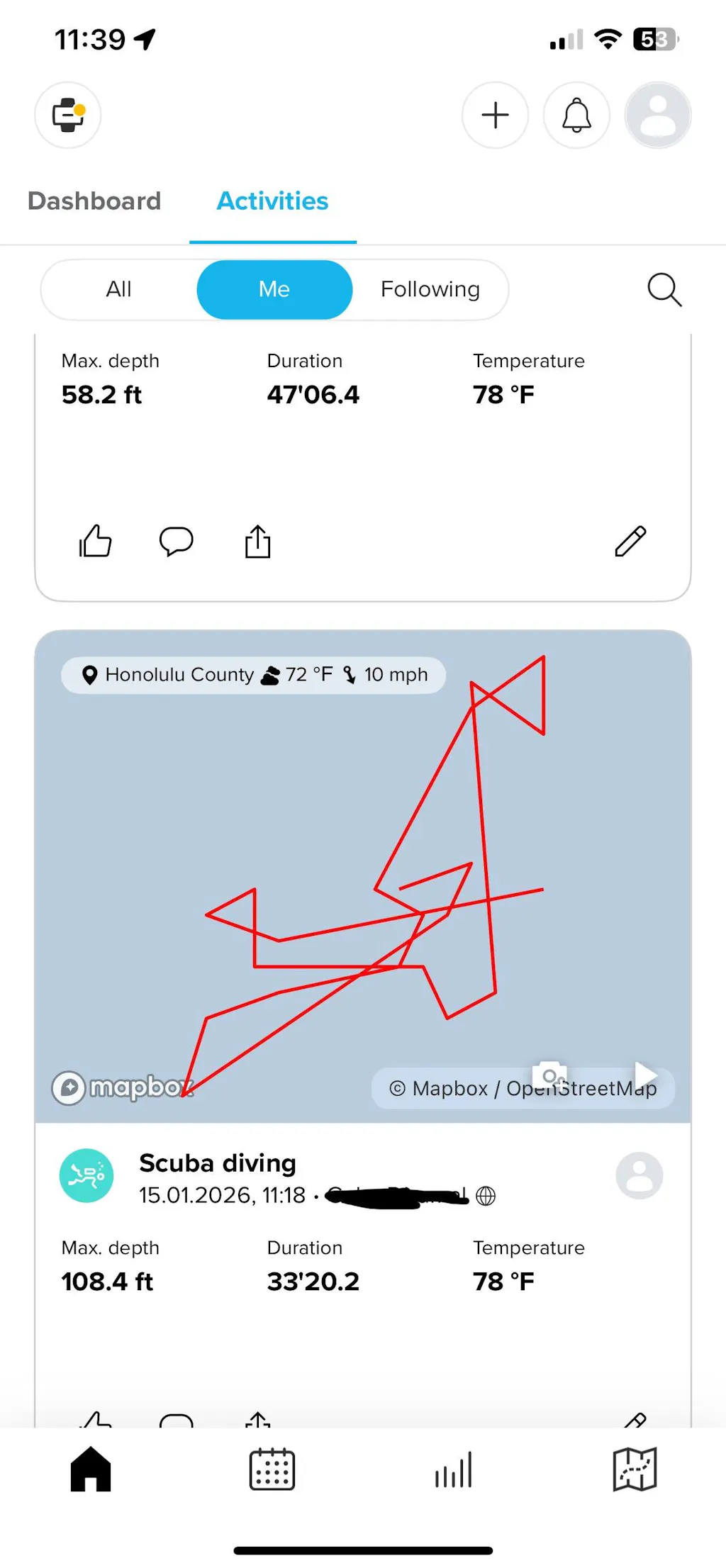

The Suunto app syncs seamlessly and automatically logs every dive, making post dive review simple and clean.
If money is not your concern and you want the best overall value, this computer delivers far more than its price suggests. Whether you are a new diver or an experienced one, this is a dive computer you can confidently buy once and keep for life. This is a top tier dive computer!!!
